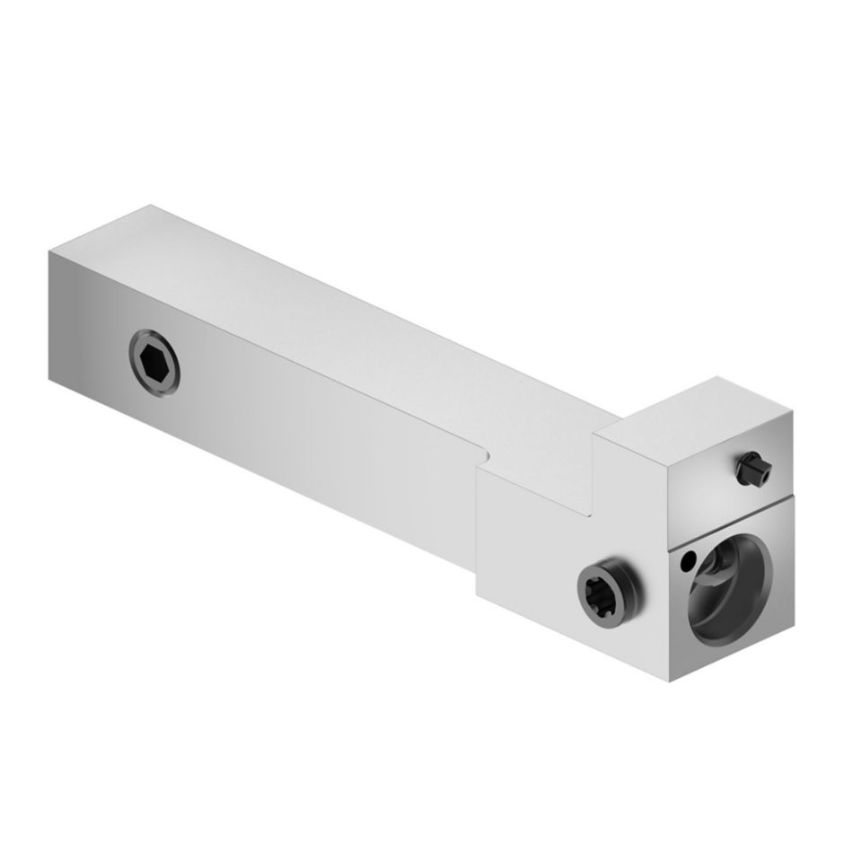

KM-CM-HPCR • Square Shank • KM Micro™ Clamping Units • Inch
Small Parts • Swiss Type
Material Number7272061
ISO Catalog IDKM12RCM08400HPCRANSI Catalog IDKM12RCM08400HPCR
$354.00/each
  • Coolant - Through Coolant 70 bar (1000 psi) MaximumCoolant - Through Coolant 70 bar (1000 psi) Maximum
  • Shank - KM MicroShank - KM Micro
Drawings for 7272061
[CSWS] System Size Workpiece SideKM12
[B] Shank Width 12.7 mm
[B] Shank Width 0.5 in
[H] Shank Height 12.7 mm
[H] Shank Height 0.5 in
[H1] Centerline Height 6.7 mm
[H1] Centerline Height 0.2638 in
[H2] Overall Height 21.6 mm
[H2] Overall Height 0.8504 in
[F] F Dimension 8 mm
[F] F Dimension 0.315 in
[L1] Gage Length101.6 mm
[L1] Gage Length4 in
[LH] Head Length 10 mm
[LH] Head Length 0.39 in
[CS] Coolant Supply SizeM8 X 1
Torque Catalog Foot Pounds5
  • Dual coolant delivery system for optimum cooling of the cutting edge and improved chip evacuation.
  • 3-point taper/face interference fit for superior connection strength and rigidity.
