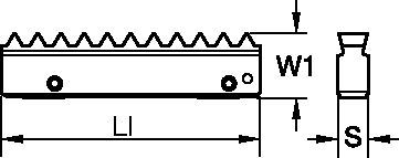

[LI] Insert Length 41 mm
[LI] Insert Length 1.614 in
[W1] Insert Width 9.95 mm
[W1] Insert Width 0.3917 in
[S] Insert Thickness4.76 mm
[S] Insert Thickness0.1874 in
