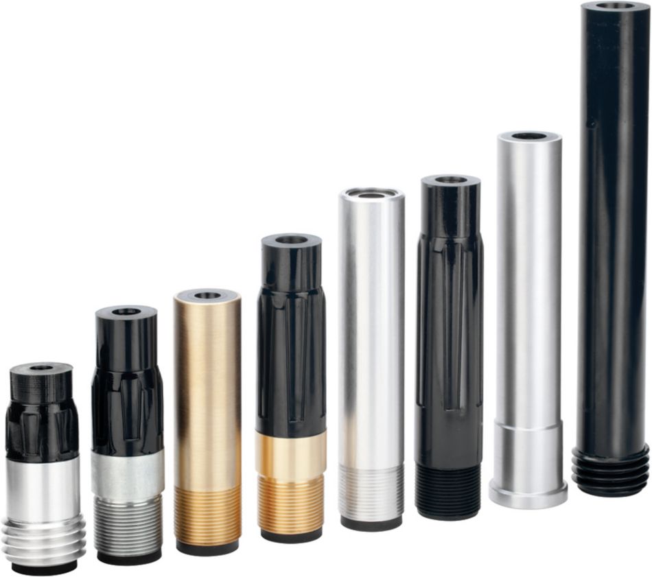

A grouping of long Venturi blast nozzles.

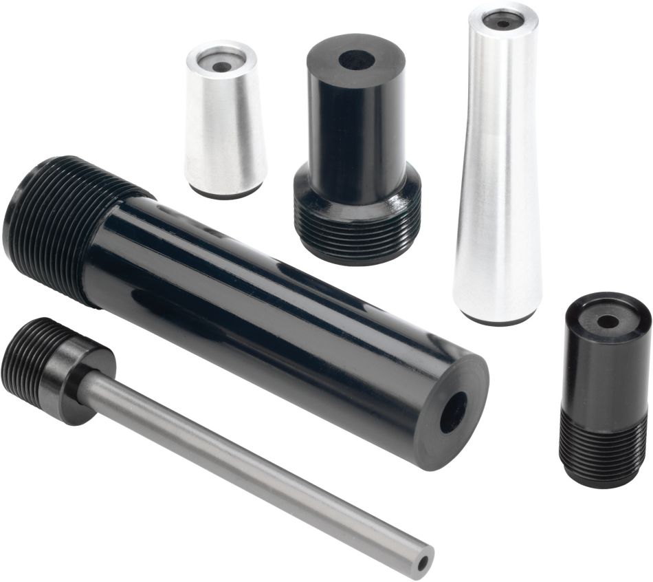

Straight-Bore Nozzles
