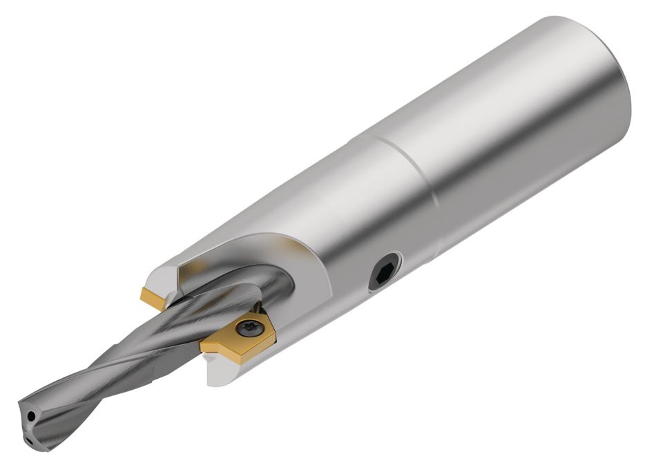

BF Combination Tool • Toolholder • SS Shank • Metric
Combination Tooling • Straight Shank (SS)
Material Number1245729
ISO Catalog ID3.37161R332ANSI Catalog ID3.37161R332

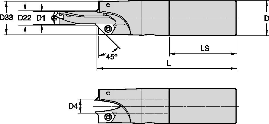

Drawings for 1245729
[D33] Cut Diameter 3 33.5 mm
[D33] Cut Diameter 3 1.3189 in
[D22] Cut Diameter 2 20.3 mm
[D22] Cut Diameter 2 0.7992 in
[D1] Drill Diameter M 15.5 mm
[D1] Drill Diameter M 0.61 in
[D1MAX] Drill Diameter Maximum16 mm
[D1MAX] Drill Diameter Maximum0.63 in
[D4] Mount Bore Diameter 16 mm
[D4] Mount Bore Diameter 0.63 in
[L] Overall Length 127.1 mm
[L] Overall Length 5.0039 in
[LS] Shank Length 60 mm
[LS] Shank Length 2.3622 in
[D] Adapter / Shank / Bore Diameter1.2598 in
  • 100081104100081104
  • 100084057100084057
  • For combined drilling and countersinking applications.
  • Applicable for solid carbide drills and KenTIP FS modular drills.
