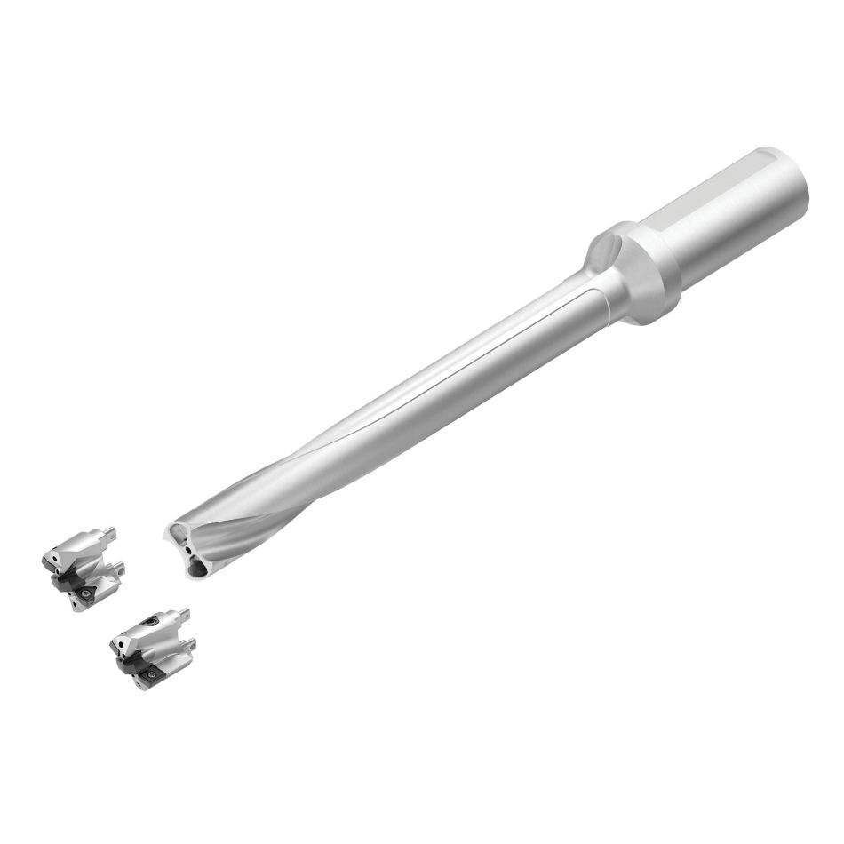

KSEM PLUS™ • Drill Body • 8 x D • SSF Shank • Inch
Modular Drilling • Flanged Shank (SSF)
Material Number3794839
ISO Catalog IDSSF150FDS361421ANSI Catalog IDSSF150FDS361421
Shank - Cylindrical with Flat and Flange
- Overview
- Application Data
- Downloads
- Spare Parts
| Material Number | 3794839 |
| ISO Catalog ID | SSF150FDS361421 |
| ANSI Catalog ID | SSF150FDS361421 |
| [CSWS] System Size Workpiece Side | FDS36 |
| [D] Adapter / Shank / Bore Diameter | 38.1 mm |
| [D] Adapter / Shank / Bore Diameter | 1.5 in |
| [L1] Gage Length | 361 mm |
| [L1] Gage Length | 14.2126 in |
| [L2] Usable Length | 292 mm |
| [L2] Usable Length | 11.4961 in |
| [LS] Shank Length | 95.25 mm |
| [LS] Shank Length | 3.75 in |
- Use KSEM PLUS™ A1 head for lowest cost per hole.
- Use KSEM PLUS™ B1 head for challenging conditions like stacked plates, cross holes, and inclined exits.
- Stable double flat shank, featuring a lateral coolant entry on the flange for drilling applications on lathes.
