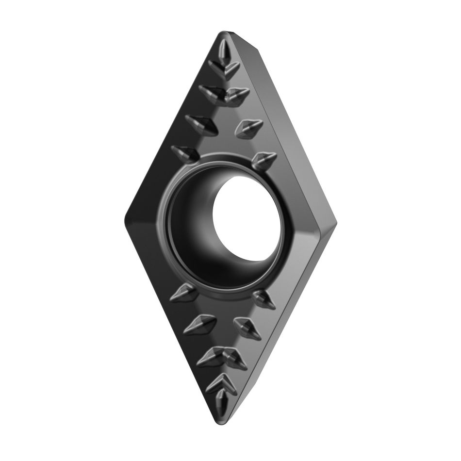

Positive Inserts • DPMT-MP
Screw-On Inserts
Material Number3744897
ISO Catalog IDDPMT11T308MPANSI Catalog IDDPMT3252MP
- P Steel
Material Number | 3744897 |
ISO Catalog ID | DPMT11T308MP |
ANSI Catalog ID | DPMT3252MP |
Grade | KCP25 |
[D] Insert IC Size | 9.525 mm |
[D] Insert IC Size | 0.375 in |
[L10] Insert Cutting Edge Length | 11.628 mm |
[L10] Insert Cutting Edge Length | 0.4578 in |
[S] Insert Thickness | 3.97 mm |
[S] Insert Thickness | 0.1563 in |
[Rε] Corner Radius | 0.8 mm |
[Rε] Corner Radius | 0.031 in |
[D1] Insert Hole Size | 4.4 mm |
[D1] Insert Hole Size | 0.1732 in |
- Steel
KCP25
Composition: A tough cobalt-enriched carbide grade with a newly designed multilayer MTCVD-TiCN-Al2O3 coating with superior interlayer adhesion.
Application: Best general-purpose turning grade for most steels and ferritic and martensitic stainless steels. The substrate design ensures adequate deformation resistance with excellent insert edge strength. Coating layers offer good wear resistance over a wide range of machining conditions and the post-coat treatment minimises microchipping and improves coating adhesion to substrate leading to long tool life and improved workpiece finishes.
- Medium geometry with positive rake face for chip control in difficult materials.
