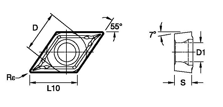

Drawings for 7161015
Material Number7161015
ISO Catalog IDDCMT150408MPS
ANSI Catalog IDDCMT432MPS
GradeKTP25S
[D] Insert IC Size12.7 mm
[D] Insert IC Size0.5 in
[S] Insert Thickness4.76 mm
[S] Insert Thickness0.187 in
[Rε] Corner Radius 0.8 mm
[Rε] Corner Radius 0.031 in
[D1] Insert Hole Size 5.5 mm
[D1] Insert Hole Size 0.2165 in
