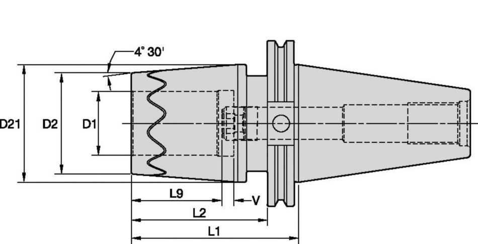

Drawings for 5089663
Material Number5089663
ISO Catalog IDCV50ZBSFHDTT50M551
ANSI Catalog IDCV50ZBSFHDTT50M551
[D1] Adapter / Shank / Bore Diameter50 mm
[D1] Adapter / Shank / Bore Diameter1.969 in
[D2] Body Diameter 1 Workpiece Side 82 mm
[D2] Body Diameter 1 Workpiece Side 3.228 in
[D21] Body Diameter 2 Workpiece Side94 mm
[D21] Body Diameter 2 Workpiece Side3.701 in
[L1] Gage Length140 mm
[L1] Gage Length5.512 in
[L2] Usable Length 120.9 mm
[L2] Usable Length 4.76 in
[L9] Clamping Length 78 mm
[L9] Clamping Hole Length 3.071 in
[V] Adjustment Range 10 mm
[V] Adjustment Range 0.394 in
Weight Kilograms6.77
