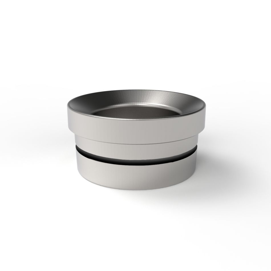

Frac Seats are consumable items utilized in hydraulic fracturing pumps, also called frac pumps or fluid ends, designed to provide a sealing surface allowing the frac pump to pressurize the slurry to be pumped into the formation. Frac seats are generally manufactured using steel to combat the extremely abrasive environment they experience within the frac pump. They withstand extreme pressures and abrasion while facilitating efficient fluid flow.
Kennaflow valve seat
What are Frac Seats?
Carbide vs Steel Frac Seats
Understanding the types of materials used to construct a frac seat can make a major difference between using seats that may roughly last 100 hours or so before changing them out or using them until the fluid ends reach end of life– which could be more than 2000 hours.
Steel: Frac seats made from steel provide good durability and are resistant to wear, but it’s not as wear-resistant as carbide. Compared to carbide, steel seats can lose their sealing surface integrity when they are exposed to highly abrasive fracking fluids. Additionally, steel is generally a more economical first choice, but has higher overall maintenance and labor costs associated with its use in a fluid end.
Carbide: Frac seats manufactured from carbide are an extremely hard material and are significantly more wear resistant than steel. Compared to steel, carbide seats can maintain high-pressure integrity and withstand the abrasive nature of fracking fluids for longer periods of time. Carbide frac seats may have a higher cost attached to them up front, however, the longer lifespan makes them more cost-effective overall.
The KennaFlow Carbide Frac Seat Advantage
KennaFlow carbide frac seats from Kennametal feature a full open seat design and are offered in standard P4 and P5 sizes for use in industry-standard fluid ends. KennaFlow seats align with the industry's ongoing pursuit of efficiency and reliability in the well-completion processes.
