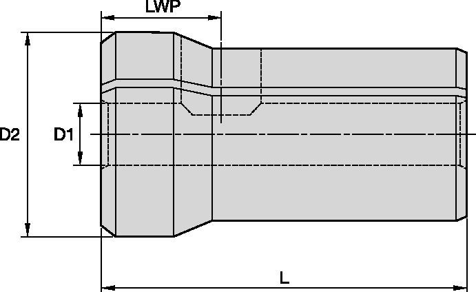

Drawings for 1014574
Material Number1014574
ISO Catalog ID300DA0094
ANSI Catalog ID300DA0094
[D1] Clamping Diameter Maximum2.383 mm
[D1] Clamping Diameter Maximum0.0938 in
[CCCX] Collet Capacity Maximum2.383 mm
[CCCX] Collet Capacity Maximum0.0938 in
  • Drilling - No CoolantDrilling - No Coolant
  • Coolant - Through Coolant 70 bar (1000 psi) MaximumCoolant - Through Coolant 70 bar (1000 psi) Maximum
  • For bonded collet DAC only — rubber-filled slots seal collet for coolant-fed tool applications.
  • Provides 1:1 grip for most drilling, reaming, and tapping applications.
  • Industry-standard Erickson™ double-angle collet system.
  • 000DA 0,25mm (.010") to 0,38mm (.015") range of collapse dependent on collet capacity.
  • 300DA, 200DA, 100DA, and 180DA 0,30mm (.012") to 0,80 mm (.031") range of collapse dependent on collet capacity.
  • 200 DAC, 100DAC, 180DAC, and 180DANP 0,13mm (.005") range of collapse.
  • 0,025mm (.001") TIR collet accuracy.
