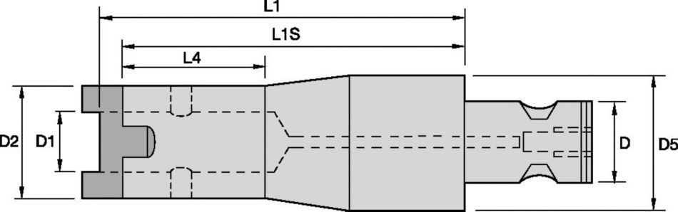

Drawings for 1300343
Material Number1300343
ISO Catalog ID5.34270R058100
ANSI Catalog ID5.34270R058100
Coupling Size Workpiece Side32
Coupling Size Machine Side40
[D2] Body Diameter 1 Workpiece Side 57.6 mm
[D2] Body Diameter 1 Workpiece Side 2.268 in
[D5] Body Diameter70 mm
[D5] Body Diameter2.7559 in
[L1] Gage Length113.9 mm
[L1] Gage Length4.4843 in
[L1S] Secondary Tool Length 100 mm
[L1S] Secondary Tool Length 3.937 in
[L4] Flange Length58.9 mm
[L4] Flange Length2.319 in
Torque Newton Meters20.337
Torque Foot Pounds15
  • Reducers are shipped with drive ring and clamping screws.

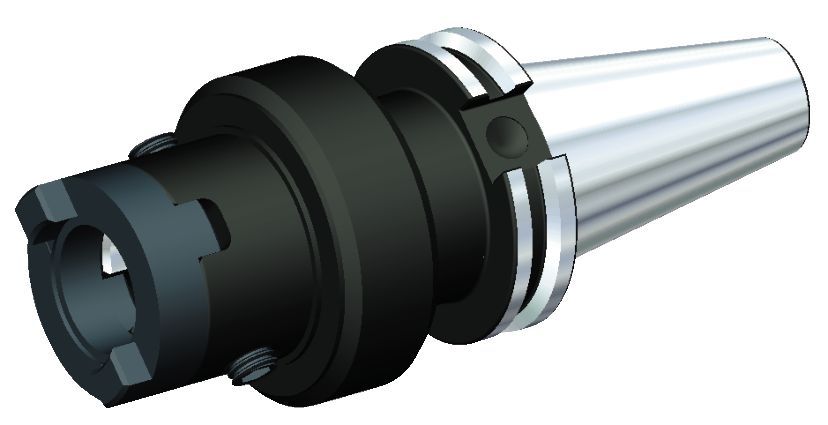

HTS • DV Taper Shank • Form B/AD Coolant
1134609
5.36050-154040
5.36050154040
HTS-HTS Reducer
1134666
5.34280R070150
5.34280R070150
HTS • CV Taper • Form AD • with Rotary Coolant Ring
HTS • BT Taper Shank • Form B/AD Coolant
1749286
BT50BHTS40080M
BT50BHTS40080M
HTS • CV Taper Shank • Form B/AD Coolant
1749430
CV50BHTS40M314
CV50BHTS40M314
