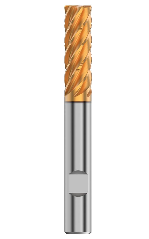

KOR6™ DT Solid Carbide End Mill for Dynamic Milling of Titanium
物料号100159668
通用表示形式
请联系我们的销售人员来了解您的定价。
- Designed for trochoidal milling with low radial engagement and full length of cut.
- With chip splitters for ideal chip evacuation.
- Proprietary flute form reduces vibrations and improves tool life.
- Helix angle tailored to minimize vibration and optimize tool life.
- Front end geometry designed for maximum tool life in helical and ramping operations.
- Centre cutting for plunging and ramping operations.

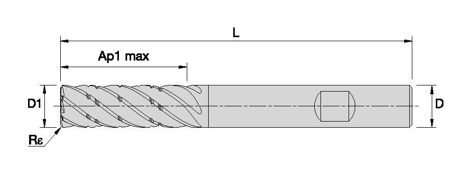

刀具尺寸: 排屑槽数: 6
刀柄— 圆柱 Weldon
螺旋角: 38°
刀尖类型: 刀尖半径
