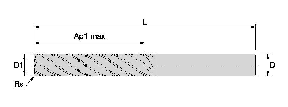

- Designed for trochoidal milling with low radial engagement and full length of cut.
- With chip splitters for ideal chip evacuation.
- Proprietary flute form reduces vibrations and improves tool life.
- Helix angle tailored to minimize vibration and optimize tool life.
- Front end geometry designed for maximum tool life in helical and ramping operations.
- Centre cutting for plunging and ramping operations.

刀具尺寸: 排屑槽数: 6
刀柄 — 圆柱 平面
螺旋角: 38°
刀尖类型: 刀尖半径
