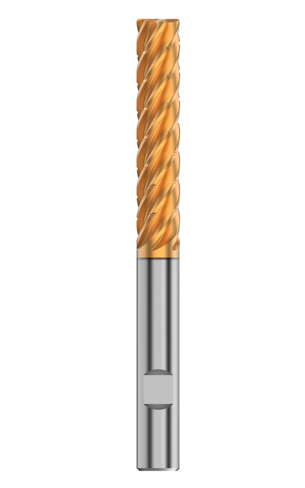

KOR6™ <sup>DT</sup> • Radiused • 6 Flutes • 5 x D • Weldon® Shank • Inch
KOR6™ DT • Radiused • 6 Flutes • 5 x D • Weldon® Shank • Inch
KOR6™ DT Solid Carbide End Mill for Dynamic Milling of Titanium
物料号100159671
通用表示形式
请联系我们的销售人员来了解您的定价。
- Designed for trochoidal milling with low radial engagement and full length of cut.
- With chip splitters for ideal chip evacuation.
- Proprietary flute form reduces vibrations and improves tool life.
- Helix angle tailored to minimize vibration and optimize tool life.
- Front end geometry designed for maximum tool life in helical and ramping operations.
- Centre cutting for plunging and ramping operations.
Trochoidal Milling
坡铣: 毛坯
侧铣/方肩铣削: 方头立铣
刀具尺寸: 排屑槽数: 6
刀柄— 圆柱 Weldon
螺旋角: 38°
刀尖类型: 刀尖半径

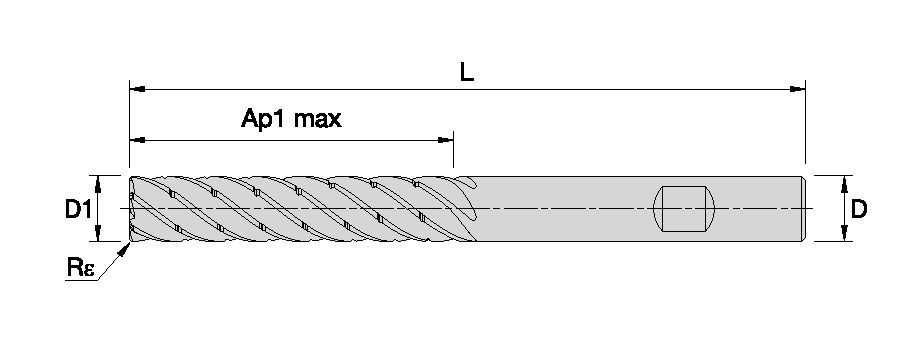

KOR6™ DT • 6 Flutes • 5 x D • Adjustment factor table for feed calculation • Inch
| Ae/D1 | 0.50% | 1.00% | 1.50% | 2.00% | 4.00% | 5.00% | |
| Speed factor | Kv | 2.00 | 1.97 | 1.93 | 1.38 | 1.03 | 1.00 |
| Feed factor | KFz | 1.27 | 1.18 | 1.14 | 1.09 | 1.05 | 1.00 |
