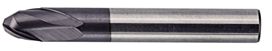

KenCut™ HM • F2AL-WLMX • Ball Nose • 2 Flutes • Long • Plain Shank • Metric
KenCut™ HM Solid Carbide End Mill for Finishing of Steels and Hard Materials
Material Number100003485
- Centre cutting for plunging and ramping operations.
- Solid carbide end mills for machining of hard materials greater than 60HRC.
Side Milling/Shoulder Milling: Ball Nose
3D Profiling
Tool Dimensions: Flute Configuration: 2
Helix Angle: 30°
Corner Style: Ball Nose

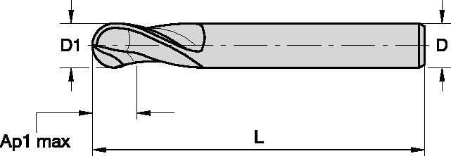

End Mill Tolerances | |||
D1 | tolerance h10 + / - | D | tolerance h6 + / - |
≤3 | +0/-0,040 | ≤3 | +0-/0,006 |
+0/-0,048 | +0/-0,008 | ||
+0/-0,058 | +0/-0,009 | ||
+0/-0,070 | +0/-0,011 | ||
+0/-0,084 | +0/-0,013 |
