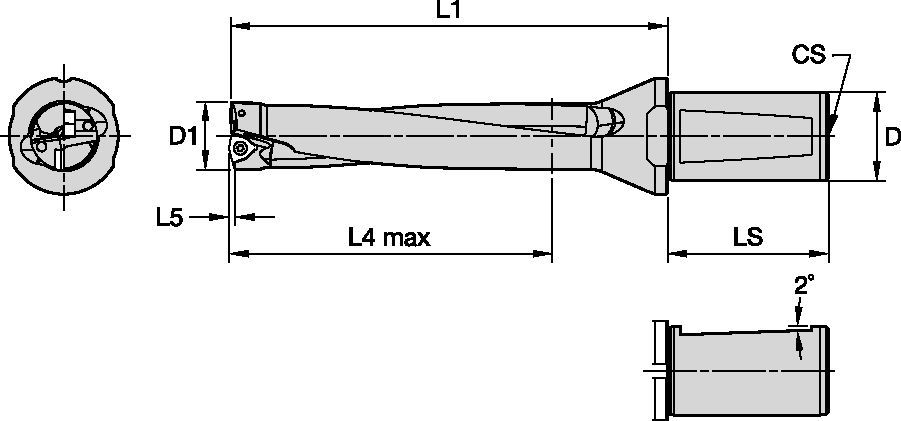

Drawings for 5689449
Material Number5689449
ISO Catalog IDDFSP260R5WD32M
ANSI Catalog IDDFSP260R5WD32M
[D] Adapter / Shank / Bore Diameter1.2598 in
[D1] Drill Diameter M 26 mm
[D1] Drill Diameter M 1.0236 in
[L1] Insert Gage Length 164 mm
[L1] Insert Gage Length 6.4567 in
[L4] Maximum Drilling Depth 130 mm
[L4] Maximum Drilling Depth 5.1181 in
[L5] Drill Point Length0.71 mm
[L5] Drill Point Length0.028 in
[LS] Shank Length 58 mm
[LS] Shank Length 2.2835 in
[CS] Coolant Supply SizeR 1/4
Gage InsertSPPX09T3.
Gage Insert 2DFT05T3.
