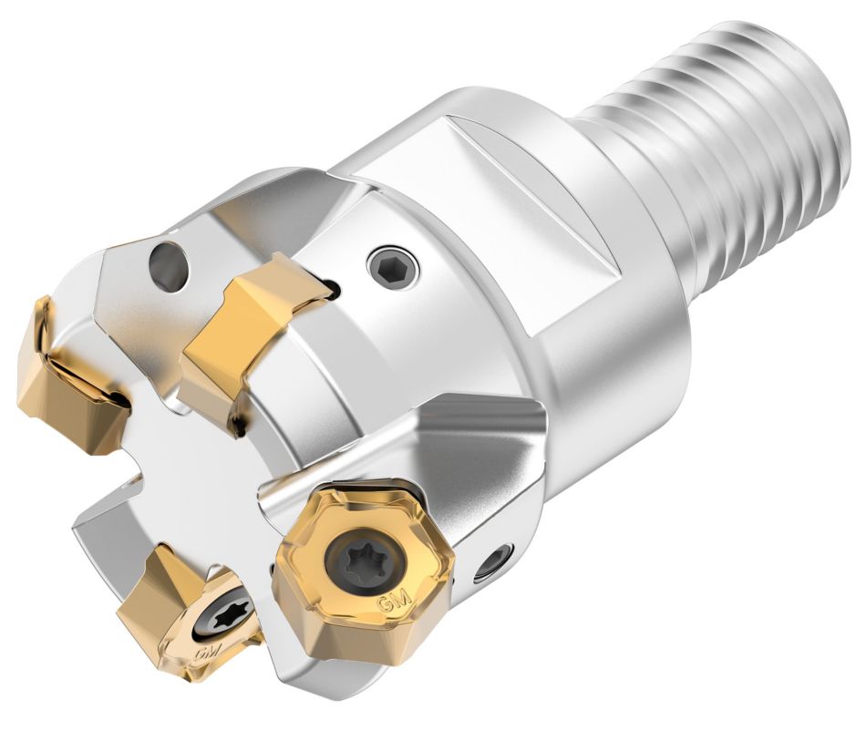

Dodeka™ Mini 45° • End Mill • Screw-On • Metric
Face milling cutter for multiple materials
Material Number4126344
ISO Catalog IDKSHR032D04M16HN06ANSI Catalog IDKSHR032D04M16HN06
- P Steel
- M Stainless Steel
- K Cast Iron
- N Non-Ferrous
- S High-Temp Alloys
- H Hardened Materials
- .caption
Face Milling
Side Milling/Shoulder Milling: Eased Chamfer
Shank - Screw-On
Milling - Through Coolant
- Overview
- Application Data
- Downloads
- Spare Parts
| Material Number | 4126344 |
| ISO Catalog ID | KSHR032D04M16HN06 |
| ANSI Catalog ID | KSHR032D04M16HN06 |
| [D1] Effective Cutting Diameter | 32 mm |
| [D1] Effective Cutting Diameter | 1.26 in |
| [D1MAX] Maximum Cutting Diameter | 40.173 mm |
| [D1MAX] Maximum Cutting Diameter | 1.582 in |
| [D] Adapter / Shank / Bore Diameter | 29 mm |
| [D] Adapter / Shank / Bore Diameter | 1.1417 in |
| [DPM] Pilot Diameter Machine Side | 17 mm |
| [DPM] Pilot Diameter Machine Side | 0.669 in |
| [G3X] Connection Thread Size External | M16 |
| [L1] Gage Length | 40 mm |
| [L1] Gage Length | 1.575 in |
| [WF] Width of Flat | 22 mm |
| [WF] Width of Flat | 0.866 in |
| [AP1MAX] 1st Maximum Cutting Depth | 3.23 mm |
| [AP1MAX] 1st Maximum Cutting Depth | 0.127 in |
| Number of Inserts | 4 |
| Weight Kilograms | 0.21 |
| Max RPM | 17600 |
- Steel
- Stainless Steel
- Cast Iron
- Non-Ferrous
- High-Temp Alloys
- Hardened Materials
- .caption
Face Milling
Shank - Screw-On
- Internal coolant supply.
