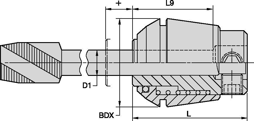

Drawings for 1092259
Material Number1092259
ISO Catalog ID11ERTCT6
ANSI Catalog ID11ERTCT6
Collet SeriesER12
Tap Range M3 & M3.15 & M3.5 mm
Tap Range #0-#6 & 1/8 in
[D1] Clamping Diameter Maximum3.581 mm
[D1] Clamping Diameter Maximum0.141 in
[BDX] Body Diameter Maximum11.4 mm
[BDX] Body Diameter Maximum0.4488 in
[L] Overall Length 21.5 mm
[L] Overall Length 0.8465 in
[L9] Clamping Hole Length 18 mm
[L9] Clamping Hole Length 0.7087 in
