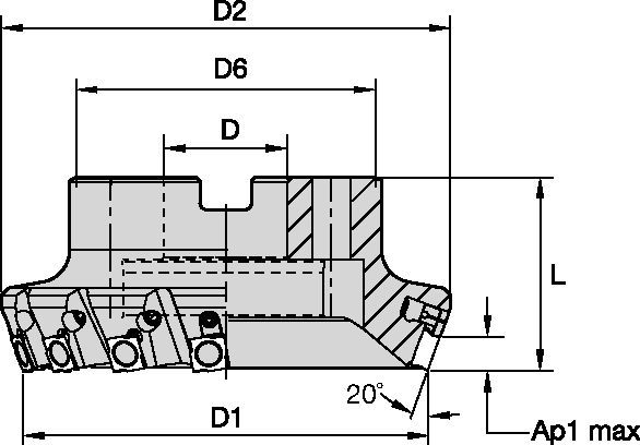

[D1] Effective Cutting Diameter50.8 mm
[D1] Effective Cutting Diameter2 in
[D] Adapter / Shank / Bore Diameter19.05 mm
[D] Adapter / Shank / Bore Diameter0.75 in
[D2] Maximum Body Diameter63.6 mm
[D2] Maximum Body Diameter2.5039 in
[D6] Hub Diameter 44.45 mm
[D6] Hub Diameter 1.75 in
[L] Overall Length 44.45 mm
[L] Overall Length 1.75 in
[AP1MAX] 1st Maximum Cutting Depth5.89 mm
[AP1MAX] 1st Maximum Cutting Depth0.232 in
Number of Inserts5
Number of Adjustable Inserts0
Weight Pounds1.19
Max RPM8595
