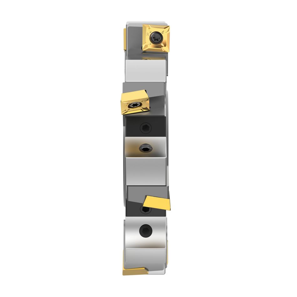

KSSM™ 12 • Slot Mill with Arbor Mount • Adjustable Cutting Width .709" to .917" • Neutral Cutting • Inch
Slot milling cutter for full slot milling in multiple materials
Material Number2268676
ISO Catalog IDKSSS500ASD43N709-813ANSI Catalog IDKSSS500ASD43N709-813
KSSM™ Slotting Cutters - 1/2" IC Inserts - KSSS™ Arbor Mount - .709" to .917" Adjustment Range - Inch 2268676 - Kennametal
$2,170.04/each
  • Slotting: SideSlotting: Side
Drawings for 2268676
[D1] Effective Cutting Diameter127 mm
[D1] Effective Cutting Diameter5 in
[D] Adapter / Shank / Bore Diameter38.1 mm
[D] Adapter / Shank / Bore Diameter1.5 in
[D6] Hub Diameter 57.15 mm
[D6] Hub Diameter 2.25 in
[CDX] Radial Maximum Depth of Cut33.807 mm
[CDX] Radial Maximum Depth of Cut1.331 in
[THUB] Hub Thickness 18.186 mm
[THUB] Hub Thickness 0.716 in
[BM] Cutting Width Minimum18.009 mm
[BM] Cutting Width Minimum0.709 in
[BMAX] Cutting Width Maximum20.65 mm
[BMAX] Cutting Width Maximum0.813 in
Number of Inserts8
Number of Effective Cutting Edges on Face4
Max RPM10300
Weight Pounds2.33
  • Unique cam adjustment mechanism enables quick tool setting and cutting width adjustment.
  • Cutter body features two keyways for staggered arbor mounting.
  • Use right-hand and left-hand inserts for best possible wall surface finish.
