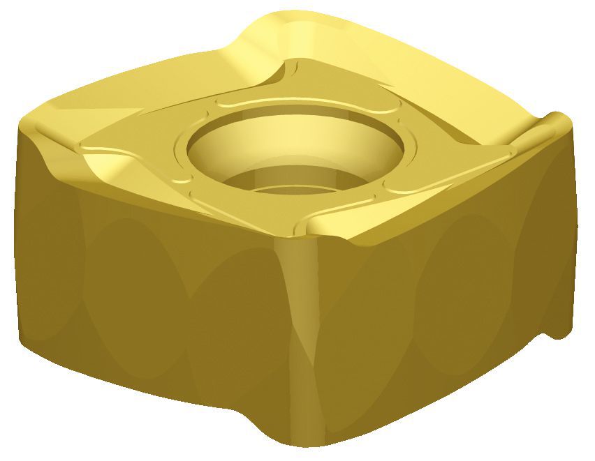

  • Double sided insert with 8 cutting edges.
  • Chip flute design for maximum metal removal and feed rate.
  • X-Grade technology for long tool life machining titanium and high temperature alloys.
  • Up to 2.5mm (0.098″) Ap capability.

7793VXO12 • Carbide Insert • XOGU-GU52 • Medium to Heavy Machining
