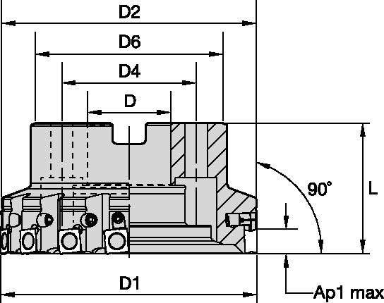

Drawings for 1503021
Número de material1503021
Referencia ISO160C12RP90SP12C3WFP
Referencia ANSI160C12RP90SP12C3WFP
Diámetro de corte efectivo [D1]160 mm
Círculo del perno 4 [D4]66.7 mm
Diámetro de núcleo [D6] 94 mm
Longitud total [L] 63 mm
1.ª profundidad de corte máxima [AP1MAX]6 mm
Número de plaquitas12
Número de plaquitas ajustables3
Peso en kilogramos3.9
RPM máx.2000

  • Milling cutters for roughing and finishing applications in cast iron and compacted graphite iron (CGI).
  • High feed rates through tangentially mounted inserts.
  • Pocket design protects non-engaged cutting edges.
  • Adjustable pockets for fine finishing with wiper inserts.
