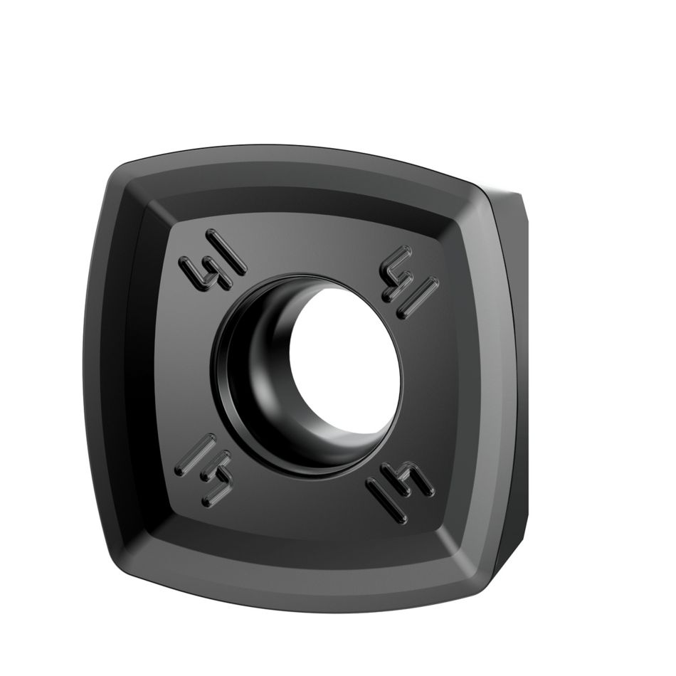

7792VXE16 Series • Carbide Insert • XEPT-D41 • Medium Machining
High-feed copy milling insert with four cutting edges.

| Objednací číslo | 6191559 |
| ISO katalogové ID | XEPT160516ERD41 |
| ANSI katalogové ID | XEPT160516ERD41 |
| Grade | KC522M |
| [D] Insert IC Size | 16.8 mm |
| [D] Insert IC Size | 0.661 in |
| [LI] Insert Length | 16.8 mm |
| [LI] Insert Length | 0.661 in |
| [S] Insert Thickness | 5.56 mm |
| [S] Insert Thickness | 0.219 in |
| [Rε] Corner Radius | 1.6 mm |
| [Rε] Corner Radius | 0.063 in |
| Average Chip Thickness [HM] | 0.05 mm |
| Average Chip Thickness [HM] | 0.002 in |
| [RT] Theoretical Corner Radius Programing | 4.44 mm |
| [RT] Theoretical Corner Radius Programing | 0.1748 in |

KC522M
Coated carbide grade with a AlTiN (PVD) coating. KC522M is engineered to provide better performance in general machining of steel, stainless steel, cast iron, and high-temperature alloys. KC522M resists breakage and offers improved wear resistance and increased strength.
Vlastnosti a výhody
- Pressed-to-size, for lowest cost per cutting edge.
- Single-sided copy milling insert for machining of steels, stainless steel, and high-temperature alloys.
