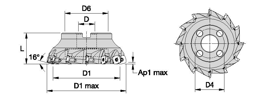

Objednací číslo | 5665812 |
ISO katalogové ID | C7792VXE16-A2.50Z5R |
ANSI katalogové ID | C7792VXE16-A2.50Z5R |
[D1MAX] Maximum Cutting Diameter | 63.3 mm |
[D1MAX] Maximum Cutting Diameter | 2.4921 in |
[D1] Effective Cutting Diameter | 39.655 mm |
[D1] Effective Cutting Diameter | 1.5612 in |
[D] Adapter / Shank / Bore Diameter | 25.4 mm |
[D] Adapter / Shank / Bore Diameter | 1 in |
[D6] Hub Diameter | 55.626 mm |
[D6] Hub Diameter | 2.19 in |
[L] Overall Length | 40 mm |
[L] Overall Length | 1.575 in |
[AP1MAX] 1st Maximum Cutting Depth | 3.5 mm |
[AP1MAX] 1st Maximum Cutting Depth | 0.138 in |
[Z] Number of Flutes | 5 |
