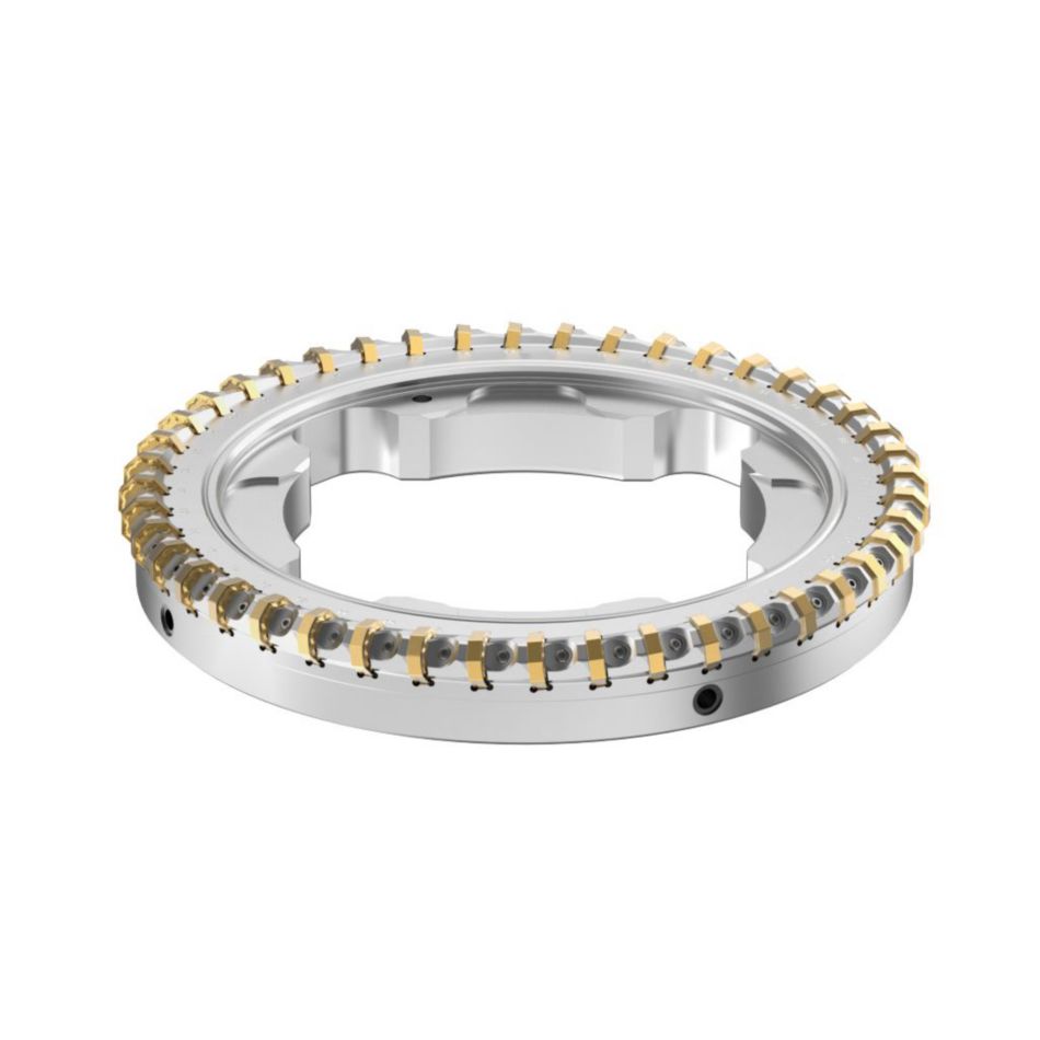

Mill 16™ • Shell Mill • Split Case • Ring • Wedge Clamping • Inch
Face Mill • Cast Iron Machining
Objednací číslo6202291
ISO katalogové IDMILL16E1400Z48ON08WSCASI katalogové IDMILL16E1400Z48ON08WSC
- P Steel
- M Stainless Steel
- K Cast Iron
- S High-Temp Alloys
- .caption
Face Milling
Milling - Side and Face
| Objednací číslo | 6202291 |
| ISO katalogové ID | MILL16E1400Z48ON08WSC |
| ASI katalogové ID | MILL16E1400Z48ON08WSC |
| [D1] Effective Cutting Diameter | 355.6 mm |
| [D1] Effective Cutting Diameter | 14 in |
| [D1MAX] Maximum Cutting Diameter | 368.15 mm |
| [D1MAX] Maximum Cutting Diameter | 14.494 in |
| [D] Adapter / Shank / Bore Diameter | 230 mm |
| [D] Adapter / Shank / Bore Diameter | 9.055 in |
| [D6] Hub Diameter | 355.6 mm |
| [D6] Hub Diameter | 14 in |
| [L] Overall Length | 45 mm |
| [L] Overall Length | 1.772 in |
| [AP1MAX] 1st Maximum Cutting Depth | 5.5 mm |
| [AP1MAX] 1st Maximum Cutting Depth | 0.215 in |
| Number of Inserts | 48 |
| Weight Pounds | 30.97 |
| Max RPM | 3300 |
