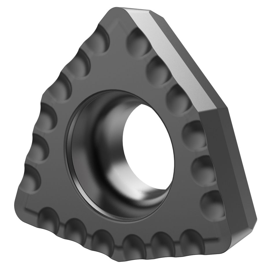

Drill Fix™ DFT™ • Břitové destičky DS
Objednací číslo6026363
ISO katalogové IDDFT06T308DSASI katalogové IDDFT06T308DS
- P Steel
- M Stainless Steel
- K Cast Iron
- N Non-Ferrous
- S High-Temp Alloys
| Objednací číslo | 6026363 |
| ISO katalogové ID | DFT06T308DS |
| ASI katalogové ID | DFT06T308DS |
| Grade | KCU40 |
| [L10] Insert Cutting Edge Length | 6.62 mm |
| [L10] Insert Cutting Edge Length | 0.26 in |
| [D] Insert IC Size | 10 mm |
| [D] Insert IC Size | 0.394 in |
| [D1] Insert Hole Size | 4.4 mm |
| [D1] Insert Hole Size | 0.173 in |
| [S] Insert Thickness | 3.75 mm |
| [S] Insert Thickness | 0.148 in |
| [Rε] Corner Radius | 0.8 mm |
| [Rε] Corner Radius | 0.031 in |
Materiály obrobků
- Steel
- Stainless Steel
- Cast Iron
- Non-Ferrous
- High-Temp Alloys
Karbidy
KCU40
Multilayered PVD TiN-TiAlN-coated fine-grain carbide, offering
highest wear resistance in steel, stainless steel, cast iron, and high-temp alloys.
Vlastnosti a výhody
- DS geometry for improved control of chip flow, chip breakage, and chip curling
- These inserts support drilling in P0 and P1 steel, higher alloyed tool steels and stainless steels where high feed rates cannot be used to provide short chips
