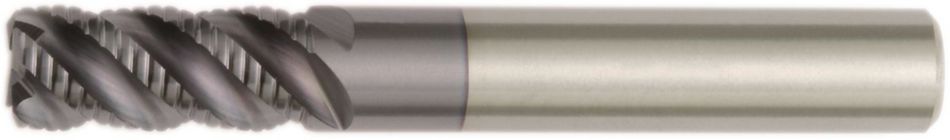

KenCut™ RR • HPRST • Rohový rádius • 4–6 břitů • Stopka Weldon® • Palcové
Monolitní čelní stopkové frézya pro hrubování nerezových ocelí, žáruvzdorných slitin a tvrzených materiálů.

  • Helix Angle: 45°Helix Angle: 45°

GradeKC643M
Adapter Style Machine SideWeldon
[D1] Effective Cutting Diameter15.875 mm
[D1] Effective Cutting Diameter0.625 in
[D] Adapter / Shank / Bore Diameter15.875 mm
[D] Adapter / Shank / Bore Diameter0.625 in
[AP1MAX] 1st Maximum Cutting Depth19.05 mm
[AP1MAX] 1st Maximum Cutting Depth0.75 in
[L3] Usable Length19.05 mm
[L3] Usable Length0.75 in
[L] Overall Length 76.2 mm
[L] Overall Length 3 in
[Re] Corner Radius 1.025 mm
[Re] Corner Radius 0.04 in
[Z] Number of Flutes4

Coated fine-grain grade with PVD multilayer (AlTiN). KC643M™ is a very thin and hard PVD coating particularly suited for cutting steel, cast iron, stainless steel (wet), and titanium (wet). This grade can be used for materials with hardness up to 52 HRC.
Vlastnosti a výhody
  • Solid carbide end mill with flat shallow profile, offering a good compromise between surface finish and power consumption
