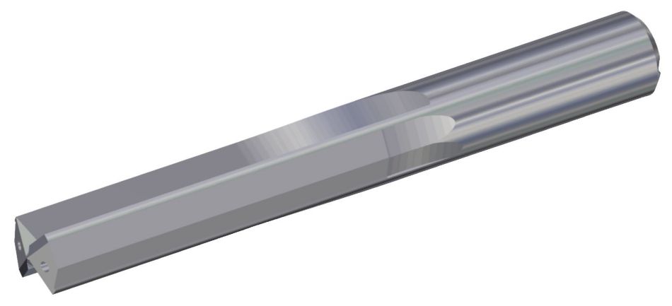

K411• KF1 • Vrtáky TX se stopkou A • ~5xD
Vrtáky TX • Otvory s těsnějšími tolerancemi • S vnitřním rozvodem chlazení

GradeKF1
[D1] Drill Diameter M 4.7625 mm
[D1] Drill Diameter M 0.1875 in
[L] Overall Length 74 mm
[L] Overall Length 2.9134 in
[L3] Flute Length 35.5 mm
[L3] Flute Length 1.3976 in
[L4] Maximum Drilling Depth 28.6 mm
[L4] Maximum Drilling Depth 1.126 in
[L5] Drill Point Length1.03 mm
[L5] Drill Point Length0.0406 in
[LS] Shank Length 36.5 mm
[LS] Shank Length 1.437 in
[D] Adapter / Shank / Bore Diameter4.7625 mm
[D] Adapter / Shank / Bore Diameter0.1875 in
Materiály obrobků
Použití
  • DrillingDrilling
  • Drilling: Inclined EntryDrilling: Inclined Entry
  • Tool Dimensions: 2flute/4margin/X/coolTool Dimensions: 2flute/4margin/X/cool
  • Helix Angle: 0°Helix Angle: 0°
Karbidy
KF1
KF1
  • Uncoated finest grain carbide.
  • Highly wear-resistant grade.
  • First choice for precision drilling of non-ferrous materials.
  • High cutting performance with excellent surface quality due to the excellent geometry of the TX Drill.
Vlastnosti a výhody
  • TX drills with through coolant for close tolerance holes.
  • Material-specific SC drill that has an X-shaped, free-cutting 130° point design and is designed for gray cast iron, nodular iron, and non-ferrous and aluminum alloy materials.
  • Can run into cored holes.
  • Two cutting edges with straight flutes for precise shape of the hole even if used as platform for complex step drills.
  • Four-margin land design with second set of cutting margin lands improve the surface quality and achieve tight diameter tolerances.
