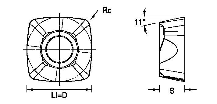

Drawings for 5654267
Material Number5654267
ISO Catalog IDXPLT060308ERD41
ANSI Catalog IDXPLT060308ERD41
GradeSP6519
[D] Insert IC Size7 mm
[D] Insert IC Size0.276 in
[LI] Insert Length 7 mm
[LI] Insert Length 0.276 in
[S] Insert Thickness3.174 mm
[S] Insert Thickness0.125 in
[Rε] Corner Radius 0.8 mm
[Rε] Corner Radius 0.031 in
Average Chip Thickness [HM]0.04 mm
Average Chip Thickness [HM]0.0016 in
[RT] Theoretical Corner Radius Programing1.37 mm
[RT] Theoretical Corner Radius Programing0.054 in
