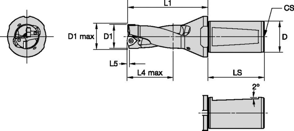

Drawings for 5689554
Material Number5689554
ISO Catalog IDDFSP200R2WD32M
ANSI Catalog IDDFSP200R2WD32M
[D] Adapter / Shank / Bore Diameter1.259 in
[D1] Drill Diameter M 20 mm
[D1] Drill Diameter M 0.79 in
[D1MAX] Drill Diameter Maximum21 mm
[D1MAX] Drill Diameter Maximum0.8268 in
[L1] Insert Gage Length 72 mm
[L1] Insert Gage Length 2.835 in
[L4] Maximum Drilling Depth 40 mm
[L4] Maximum Drilling Depth 1.575 in
[L5] Drill Point Length0.63 mm
[L5] Drill Point Length0.025 in
[LS] Shank Length 58 mm
[LS] Shank Length 2.283 in
Gage InsertSPGX0603.
Gage Insert 2DFT0303.
