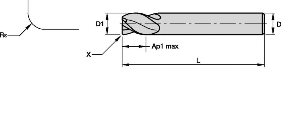

Drawings for 4047705
Material Number4047705
ISO Catalog IDHPHV188S4031LR015
ANSI Catalog IDHPHV188S4031LR015
GradeKCPM15
[Re] Corner Radius 0.375 mm
[Re] Corner Radius 0.015 in
[Z] Number of Flutes4
[D1] Effective Cutting Diameter4.763 mm
[D1] Effective Cutting Diameter0.1875 in
[D] Adapter / Shank / Bore Diameter4.763 mm
[D] Adapter / Shank / Bore Diameter0.1875 in
[AP1MAX] 1st Maximum Cutting Depth7.938 mm
[AP1MAX] 1st Maximum Cutting Depth0.3125 in
[L3] Usable Length7.938 mm
[L3] Usable Length0.3125 in
[L] Overall Length 63.5 mm
[L] Overall Length 2.5 in
