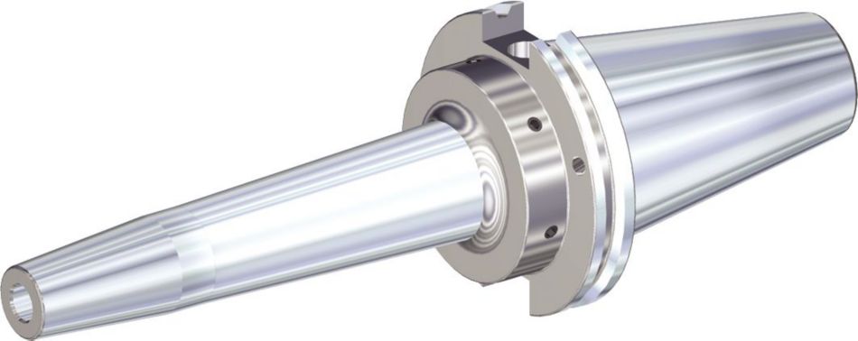

TT GP HPV MM-CV form B/AD
3615194
CV50HPVTT068400
CV50HPVTT068400
