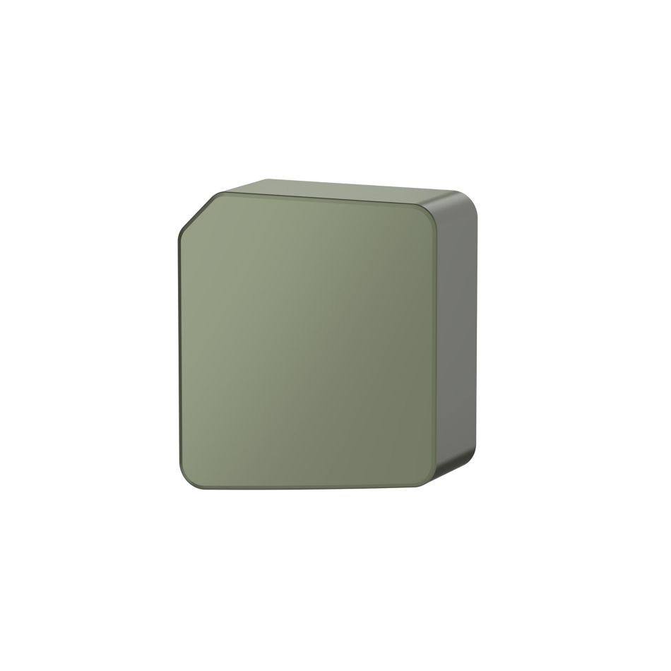

KSSR™ • Ceramic Wiper Insert • XNXF-W • High-Speed Fine-Finishing
Face milling insert with eight cutting edges, precision ground.
Material Number4061407
ISO Catalog IDXNXF1204ZNENWANSI Catalog IDXNXF43ZNENW
- K Cast Iron
| Material Number | 4061407 |
| ISO Catalog ID | XNXF1204ZNENW |
| ANSI Catalog ID | XNXF43ZNENW |
| Grade | KY3500 |
| [D] Insert IC Size | 12.7 mm |
| [D] Insert IC Size | 0.5 in |
| [S] Insert Thickness | 4.76 mm |
| [S] Insert Thickness | 0.1875 in |
| [L10] Insert Cutting Edge Length | 12.7 mm |
| [L10] Insert Cutting Edge Length | 0.5 in |
| [BS] Corner Facet Length | 9.5 mm |
| [BS] Corner Facet Length | 0.374 in |
| [Rε] Corner Radius | 1.2 mm |
| [Rε] Corner Radius | 0.047 in |
| Average Chip Thickness [HM] | 0.203 mm |
| Average Chip Thickness [HM] | 0.008 in |
| Cutting Edges per Insert | 2 |
- Cast Iron
KY3500
A ceramic cutting material based on micro-grain Si3N4 primarily for use in light to general machining of gray cast iron and ferritic ductile cast iron. Dry machining is recommended.
- Precision ground wiper insert for superior surface finish and flatness.
- Milling insert for cast iron and compacted graphite iron (CGI) machining.
