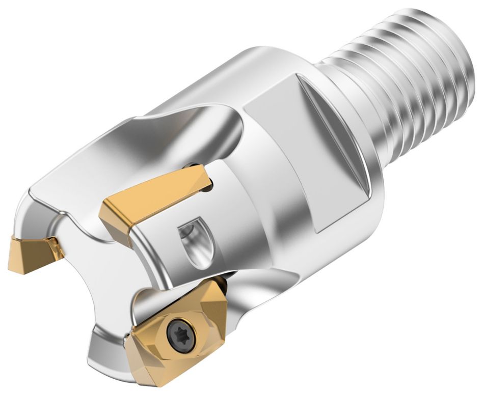

| Material Number | 2968370 |
| ISO Catalog ID | 20A02R035M10SED14 |
| ANSI Catalog ID | M1D020ME1402M010L035 |
| [D1] Effective Cutting Diameter | 20 mm |
| [D1] Effective Cutting Diameter | 0.787 in |
| [D] Adapter / Shank / Bore Diameter | 18 mm |
| [D] Adapter / Shank / Bore Diameter | 0.709 in |
| [DPM] Pilot Diameter Machine Side | 10.5 mm |
| [DPM] Pilot Diameter Machine Side | 0.413 in |
| [G3X] Connection Thread Size External | M10 |
| [L2] Head Length | 35 mm |
| [L2] Head Length | 1.378 in |
| [WF] Width of Flat | 14.95 mm |
| [WF] Width of Flat | 0.589 in |
| [AP1MAX] 1st Maximum Cutting Depth | 14.6 mm |
| [AP1MAX] 1st Maximum Cutting Depth | 0.57 in |
| Number of Inserts | 2 |
| Maximum Ramping Angle | 16.6 |
| Weight Kilograms | 0.05 |
| Max RPM | 47500 |

- Internal coolant supply
- For ramping, slotting, plunging, facing and true 90° walls
