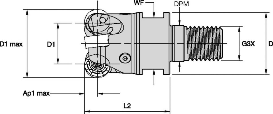

Drawings for 4147002
Material Number4147002
ISO Catalog IDKDR35Z03M16RN12
ANSI Catalog IDKDR35Z03M16RN12
[D1MAX] Maximum Cutting Diameter35 mm
[D1MAX] Maximum Cutting Diameter1.378 in
[D1] Effective Cutting Diameter23 mm
[D1] Effective Cutting Diameter0.906 in
[D] Adapter / Shank / Bore Diameter29 mm
[D] Adapter / Shank / Bore Diameter1.142 in
[DPM] Pilot Diameter Machine Side17 mm
[DPM] Pilot Diameter Machine Side0.67 in
[G3X] Connection Thread Size ExternalM16
[L2] Head Length 40 mm
[L2] Head Length 1.575 in
[WF] Width of Flat 23.95 mm
[WF] Width of Flat 0.943 in
[AP1MAX] 1st Maximum Cutting Depth3 mm
[AP1MAX] 1st Maximum Cutting Depth0.117 in
Number of Inserts3
Maximum Ramping Angle0.38
Weight Kilograms0.19
Max RPM37440
Gage InsertRN_J1204M0__
