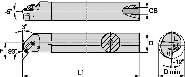

Drawings for 1098130
Material Number1098130
ISO Catalog IDA32SMVUNR16
ANSI Catalog IDA32SMVUNR16
[D] Adapter / Shank / Bore Diameter1.26 in
[DM] Minimum Bore Diameter 40 mm
[DM] Minimum Bore Diameter 1.5748 in
[F] F Dimension 22 mm
[F] F Dimension 0.8661 in
[L1] Tool Length 250 mm
[L1] Tool Length 9.8425 in
[L] Overall Length 250 mm
[L] Overall Length 9.8425 in
[LH] Head Length 55 mm
[LH] Head Length 2.166 in
[CS] Coolant Supply Size1/4-18 NPT
[A] Coolant Hole Diameter 6.4 mm
[A] Coolant Hole Dia 0.252 in
Gage InsertVN..160408
