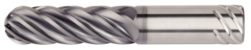

HARVI™ III Aero • Ball Nose • 6 Flutes • Safe-Lock™ Shank • Inch
HARVI™ III Aero Solid Carbide End Mill for High Feed Roughing and Finishing with Maximum Metal Removal Rates
Material Number6113404
ISO Catalog IDUJBE1000N6ABANSI Catalog IDUJBE1000N6AB
HARVI™ III Aero - Ball Nose - 6 Flutes - Safe-Lock™ Shank - Inch 6113404 - Kennametal

  • Ball Nose Trochoidal MillingBall Nose Trochoidal Milling
  • 3D Profiling3D Profiling
  • Tool Dimensions: Flute Configuration: 6Tool Dimensions: Flute Configuration: 6
Drawings for 6113404
GradeKCSM15
Adapter Style Machine SideSAFE-LOCK
[Z] Number of Flutes6
[D1] Effective Cutting Diameter25.4 mm
[D1] Effective Cutting Diameter1 in
[AP1MAX] 1st Maximum Cutting Depth38.1 mm
[AP1MAX] 1st Maximum Cutting Depth1.5 in
[L] Overall Length 114.3 mm
[L] Overall Length 4.5 in
KCSM15
KCSM15
Coated carbide grade with thick PVD coating and optimized chemistry
and process for increased wear resistance. Outstanding protection in milling stainless steel to mitigate crater, DOCN (depth-of-cut notching), and flank wear. Excellent performance up to 52 HRC.
  • Versatile solid carbide end mill for stainless steel, and high-temperature alloys.
  • HARVI™ III Aero solid carbide end mills cover a variety of operations.
  • HARVI™ III Aero solid carbide end mills feature unequal flute spacing for chatter-free machining at highest feed rates.
  • Eccentric relief grind for higher edge stability and higher feed rates.
