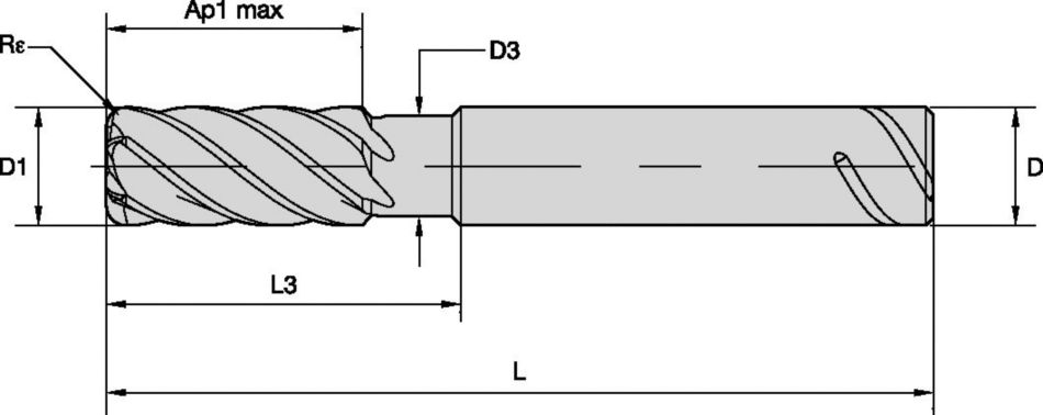

  • Tool Dimensions: Flute Configuration: 6Tool Dimensions: Flute Configuration: 6
Drawings for 5351939
Material Number5351939
ISO Catalog IDUJDE1000N6BQB
ANSI Catalog IDUJDE1000N6BQB
GradeKCSM15
Adapter Style Machine SideSAFE-LOCK
[D1] Effective Cutting Diameter25.4 mm
[D1] Effective Cutting Diameter1 in
[D3] Neck Diameter 23.876 mm
[D3] Neck Diameter 0.94 in
[AP1MAX] 1st Maximum Cutting Depth44.45 mm
[AP1MAX] 1st Maximum Cutting Depth1.75 in
[L3] Usable Length82.55 mm
[L3] Usable Length3.25 in
[L] Overall Length 139.7 mm
[L] Overall Length 5.5 in
[Re] Corner Radius 0.75 mm
[Re] Corner Radius 0.03 in
[Z] Number of Flutes6
KCSM15
KCSM15
Coated carbide grade with thick PVD coating and optimized chemistry
and process for increased wear resistance. Outstanding protection in milling stainless steel to mitigate crater, DOCN (depth-of-cut notching), and flank wear. Excellent performance up to 52 HRC.
  • Versatile solid carbide end mill for steels, stainless steel, and high-temperature alloys with excellent surfaces.
  • HARVI™ III solid carbide end mills cover a variety of operations, including dynamic milling.
  • HARVI™ III solid carbide end mills feature unequal flute spacing for chatter-free machining at highest feed rates.
  • Eccentric relief grind for higher edge stability and higher feed rates.
  • Safe-Lock for pull out protection.
