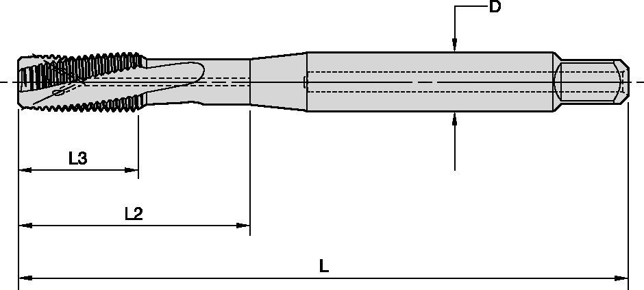

Drawings for 4028491
Material Number4028491
ISO Catalog IDT621M100X150R6HX-D1
ANSI Catalog IDT621M100X150R6HX-D1
GradeKP6525
[D1-TDZ] Thread Diameter SizeM10 X 1.5
[L] Overall Length 100 mm
[L] Overall Length 3.94 in
[L3] Thread Length 15 mm
[L3] Thread Length 0.59 in
[L2] Useable Length 39.1 mm
[L2] Useable Length 1.54 in
[D] Adapter / Shank / Bore Diameter10 mm
[D] Adapter / Shank / Bore Diameter0.3937 in
[Z] Number of Flutes3
Dimension StandardDIN 371
Thread Tolerance Class ISO6HX-I
