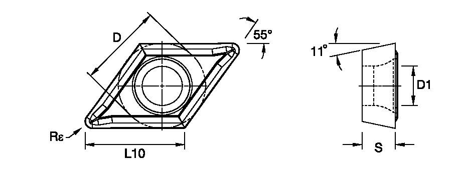

Drawings for 1161942
Material Number1161942
ISO Catalog IDDPMT070202LF
ANSI Catalog IDDPMT21505LF
GradeKC730
[D] Insert IC Size6.35 mm
[D] Insert IC Size0.25 in
[L10] Insert Cutting Edge Length7.752 mm
[L10] Insert Cutting Edge Length0.3052 in
[S] Insert Thickness2.38 mm
[S] Insert Thickness0.0938 in
[Rε] Corner Radius 0.2 mm
[Rε] Corner Radius 0.008 in
[D1] Insert Hole Size 2.9 mm
[D1] Insert Hole Size 0.1142 in
  • Finishing geometry with light cutting action.
  • Used in multiple material groups.
