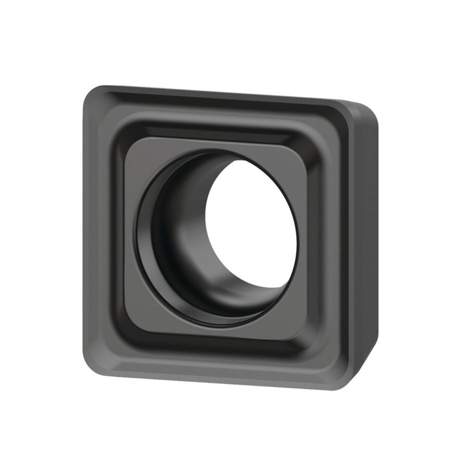

Drilling insert for Steel and Cast Iron
Material Number7034337
ISO Catalog IDDFPR050204PKOANSI Catalog IDDFPR050204PKO
Drill Fix PRO™ - Carbide Insert - Outboard - PK Geometry 7034337 - Kennametal
GradeKCU25
[D1] Insert Hole Size 2.43 mm
[D1] Insert Hole Size 0.096 in
[D] Insert IC Size5.25 mm
[D] Insert IC Size0.207 in
[Rε] Corner Radius 0.4 mm
[Rε] Corner Radius 0.016 in
[S] Insert Thickness2.4 mm
[S] Insert Thickness0.094 in

KCU25
KCU25
Composition: An advanced PVD grade with hard AlTiN coating and fine-grain unalloyed substrate. The new and improved coating improves edge stability with wide range speed and feed capabilities.
Application: The KCU25™ grade is ideal for general machining of most steels, stainless steels, high-temp alloys, titanium, irons, and non-ferrous materials in a wide range of speeds and feeds with improved edge toughness for interrupted cuts and high feed rates.
  • Four true cutting edges for lowest cost per part.
  • Outboard Insert with wiper-facets for superiour surface finish.
