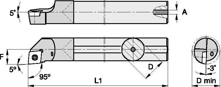

  • I.D. TurningI.D. Turning
Drawings for 1152693
Material Number1152693
ISO Catalog IDE16SCLPR3AP5
ANSI Catalog IDE16SCLPR3AP5
GradeKWH
[DM] Minimum Bore Diameter 30.226 mm
[DM] Minimum Bore Diameter 1.19 in
[F] F Dimension 15.875 mm
[F] F Dimension 0.625 in
[L1] Tool Length 304.8 mm
[L1] Tool Length 12 in
[L] Overall Length 304.8 mm
[L] Overall Length 12 in
[A] Coolant Hole Diameter 7.925 mm
[A] Coolant Hole Dia 0.312 in
[A1] Coolant Hole Diameter Exit 3.175 mm
[A1] Coolant Hole Diameter Exit 0.125 in
