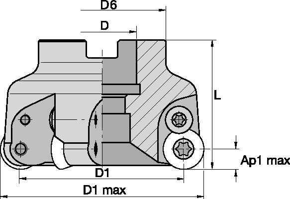

Drawings for 1888196
Material Number1888196
ISO Catalog ID52A04RSMORD16
ANSI Catalog ID52A04RSMORD16
[D1MAX] Maximum Cutting Diameter52 mm
[D1MAX] Maximum Cutting Diameter2.047 in
[D1] Effective Cutting Diameter36 mm
[D1] Effective Cutting Diameter1.4173 in
[D] Adapter / Shank / Bore Diameter22 mm
[D] Adapter / Shank / Bore Diameter0.867 in
[D6] Hub Diameter 42 mm
[D6] Hub Diameter 1.654 in
[L] Overall Length 50 mm
[L] Overall Length 1.969 in
[AP1MAX] 1st Maximum Cutting Depth8 mm
[AP1MAX] 1st Maximum Cutting Depth0.315 in
Number of Inserts4
Maximum Ramping Angle8.2
Weight Kilograms0.32
Gage InsertRD_X1604M0__
