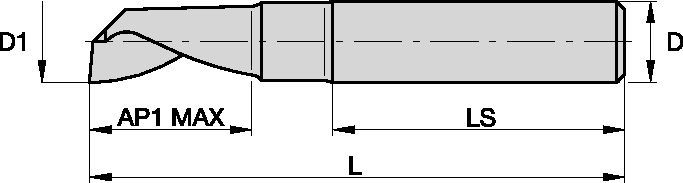

  • Tool Dimensions: Flute Configuration: 1Tool Dimensions: Flute Configuration: 1
Drawings for 2433330
Material Number2433330
ISO Catalog IDF1AA0200AWS30
ANSI Catalog IDF1AA0200AWS30
GradeK600
[D1] Effective Cutting Diameter2 mm
[D1] Effective Cutting Diameter0.0787 in
[D] Adapter / Shank / Bore Diameter2 mm
[D] Adapter / Shank / Bore Diameter0.0787 in
[AP1MAX] 1st Maximum Cutting Depth10 mm
[AP1MAX] 1st Maximum Cutting Depth0.3937 in
[L] Overall Length 40 mm
[L] Overall Length 1.5748 in
[Z] Number of Flutes1
