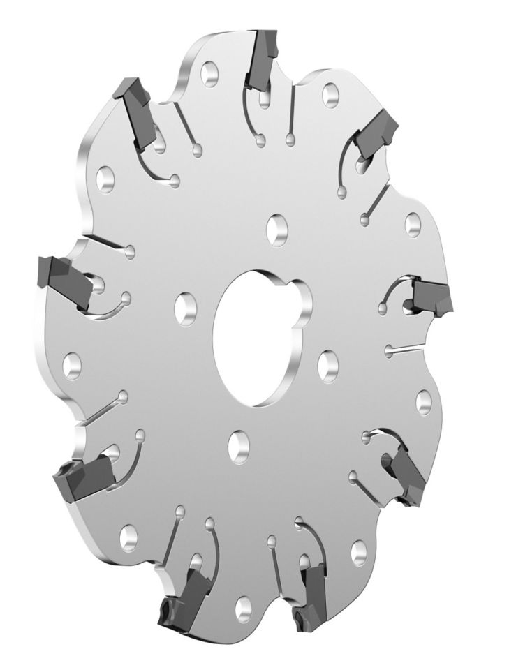

[BM] Cutting Width Minimum2.2 mm
[BM] Cutting Width Minimum0.0866 in
[D1] Effective Cutting Diameter80 mm
[D1] Effective Cutting Diameter3.15 in
[CDX] Radial Maximum Depth of Cut21 mm
[CDX] Radial Maximum Depth of Cut0.8268 in
[D] Adapter / Shank / Bore Diameter16 mm
[D] Adapter / Shank / Bore Diameter0.6299 in
[THUB] Hub Thickness 1.8 mm
[THUB] Hub Thickness 0.0709 in
Number of Inserts7
Weight Kilograms0.05
Gage Insert3.90022____
Max RPM4000
  • Slotting: Side with AE/AP dimensionsSlotting: Side with AE/AP dimensions
  • Self-clamping insert seat with fixed stop.
  • Excellent for all flat-bottom slotting and cut-off operations.
  • Two drive rings required for each cutter body. They must be ordered separately, and in pairs of two.
  • For cutter diameters 200mm and 250mm support rings are optional (instead of drive rings). Support rings also must be ordered separately, and in pairs of two.
