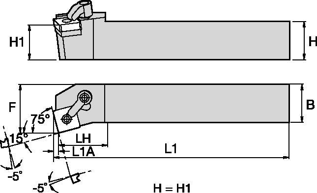

Drawings for 1808190
Material Number1808190
ISO Catalog IDMSKNR206D
ANSI Catalog IDMSKNR206D
[H] Shank Height 31.75 mm
[H] Shank Height 1.25 in
[B] Shank Width 31.75 mm
[B] Shank Width 1.25 in
[F] F Dimension 38.1 mm
[F] F Dimension 1.5 in
[L1] Tool Length 152.4 mm
[L1] Tool Length 6 in
[LH] Head Length 38.1 mm
[LH] Head Length 1.5 in
[L1A] L1 A Dimension 4.572 mm
[L1A] L1 A Dimension 0.18 in
Gage InsertSN..643
Lock Pin ID Drive Size9/64
Clamp Screw ID Drive Size5/32
