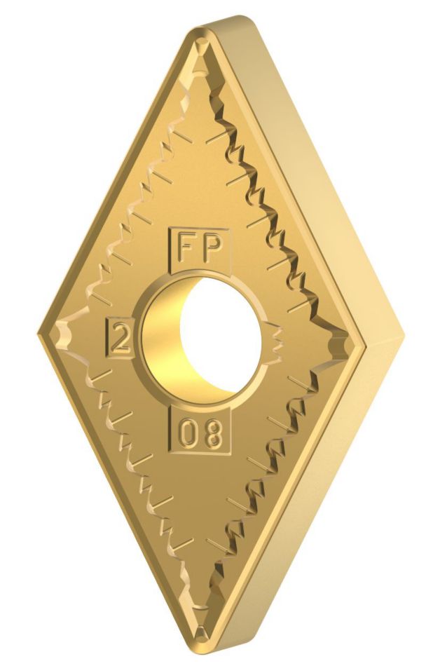

ISO Catalog IDDNMG150608FPANSI Catalog IDDNMG442FP

GradeKC5010
[D] Insert IC Size12.7 mm
[D] Insert IC Size0.5 in
[D1] Insert Hole Size 5.16 mm
[S] Insert Thickness6.35 mm
[S] Insert Thickness0.25 in
[Rε] Corner Radius 0.8 mm
[Rε] Corner Radius 0.031 in
KC5010
KC5010
Composition: An advanced PVD AlTiN coating over a very deformation-resistant unalloyed carbide substrate. The new and improved coating enables speeds to be increased by 50–100%.
Application: The KC5010 grade is ideal for finishing to general machining of most workpiece materials at higher speeds. Excellent for machining most steels, stainless steels, cast irons, non-ferrous materials, and super alloys under stable conditions. It also performs well machining hardened and short chipping materials.
  • Finishing geometry with positive rake face for chip control in difficult materials
