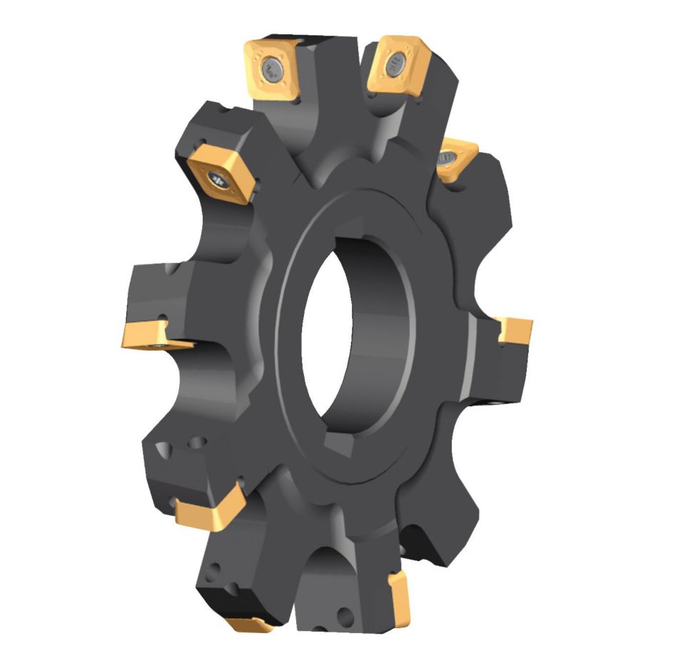

KSSM™ Fixed-Width Slotting Cutters - 10 mm IC Inserts (Neutral) • Metric
Arbor Mount • 10mm IC • Neutral (Full Slotting)
Material Number3330527
ISO Catalog ID100G10NP90SP10N16KANSI Catalog ID100G10NP90SP10N16K
KSSM Fixed-Width Slotting Cutters - 10 mm IC Inserts (Neutral) - Metric 3330527 100G10NP90SP10N16K - Kennametal.com
$1,475.25/each
  • Slotting: Side with AE/AP dimensionsSlotting: Side with AE/AP dimensions
Drawings for 3330527
[D1] Effective Cutting Diameter100 mm
[D1] Effective Cutting Diameter3.937 in
[D] Adapter / Shank / Bore Diameter1.2598 in
[D6] Hub Diameter 46.75 mm
[D6] Hub Diameter 1.841 in
[CDX] Radial Maximum Depth of Cut26.36 mm
[CDX] Radial Maximum Depth of Cut1.038 in
[THUB] Hub Thickness 13.88 mm
[THUB] Hub Thickness 0.546 in
[BM] Cutting Width Minimum15.83 mm
[BM] Cutting Width Minimum0.623 in
[AP1MAX] 1st Maximum Cutting Depth15.82 mm
[AP1MAX] 1st Maximum Cutting Depth0.623 in
Number of Inserts10
Number of Effective Cutting Edges on Face5
Max RPM17200
Weight Kilograms0.46
  • Neutral (full slotting) cutters.
  • Large selection of insert geometries and grades to cut most workpiece materials.
  • Four insert cutting edges.
  • Wide choice of insert radii.
  • Faceted inserts for superior surface finishes.
