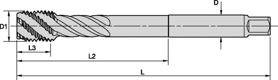

Drawings for 4059053
Material Number4059053
ISO Catalog IDT630M300X350R6HX-XL
ANSI Catalog IDT630M300X350R6HX-XL
GradeKP6525
[D1-TDZ] Thread Diameter SizeM30 X 3.5
[L] Overall Length 250 mm
[L] Overall Length 9.84 in
[L3] Thread Length 35 mm
[L3] Thread Length 1.38 in
[L2] Useable Length 150 mm
[L2] Useable Length 5.91 in
[D] Adapter / Shank / Bore Diameter22 mm
[D] Adapter / Shank / Bore Diameter0.8661 in
[Z] Number of Flutes5
Thread Tolerance Class ISO6HX-I
