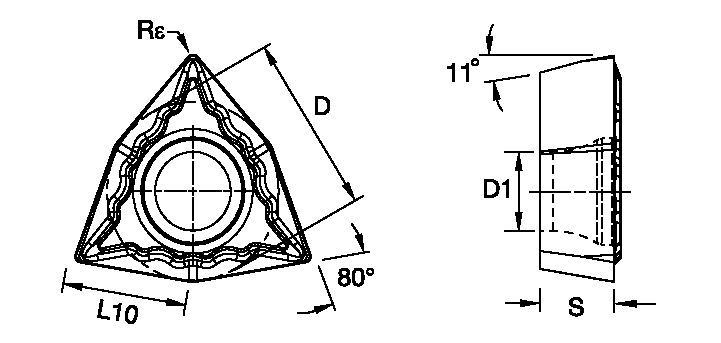

Drawings for 7096391
Material Number7096391
ISO Catalog IDWPHT040201UF
ANSI Catalog IDWPHT21502UF
GradeKCU10B
[D] Insert IC Size6.35 mm
[D] Insert IC Size0.25 in
[L10] Insert Cutting Edge Length4.344 mm
[L10] Insert Cutting Edge Length0.171 in
[S] Insert Thickness2.38 mm
[S] Insert Thickness0.094 in
[Rε] Corner Radius 0.1 mm
[Rε] Corner Radius 0.004 in
[D1] Insert Hole Size 2.8 mm
[D1] Insert Hole Size 0.11 in
